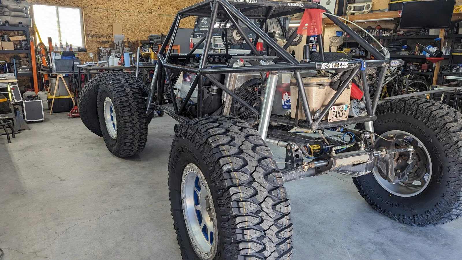

Do you know if they will offer them in a 17" wheel? I'm guessing no but thought I'd ask. How much clearance do you have under the diffs with 42's?
Under pumpkin (Toy 8") is 18" Same as my skids, or close ;)
So, Milestar has said they'd like to do 17's. IMO, I'll be surprised. These are $655ea RETAIL versus $1450 for Treps. $1450x4=$5800. $655x4=$2620. That's $3000+ for 20" beadlocks, and yoiu can sell your existing 17's. ZERO financial sense to make 17's.

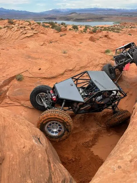

How'd the tires do? And any more pics of the car behind you? Chassis looks interesting.
Tires did great, obviously still need to work the edges to make them better, but the 3 runs I've made have been great.
That's a Hulse chassis that belongs to MattyJ - 3 Seater, super clean build. Love the lines on these and how well they perform.

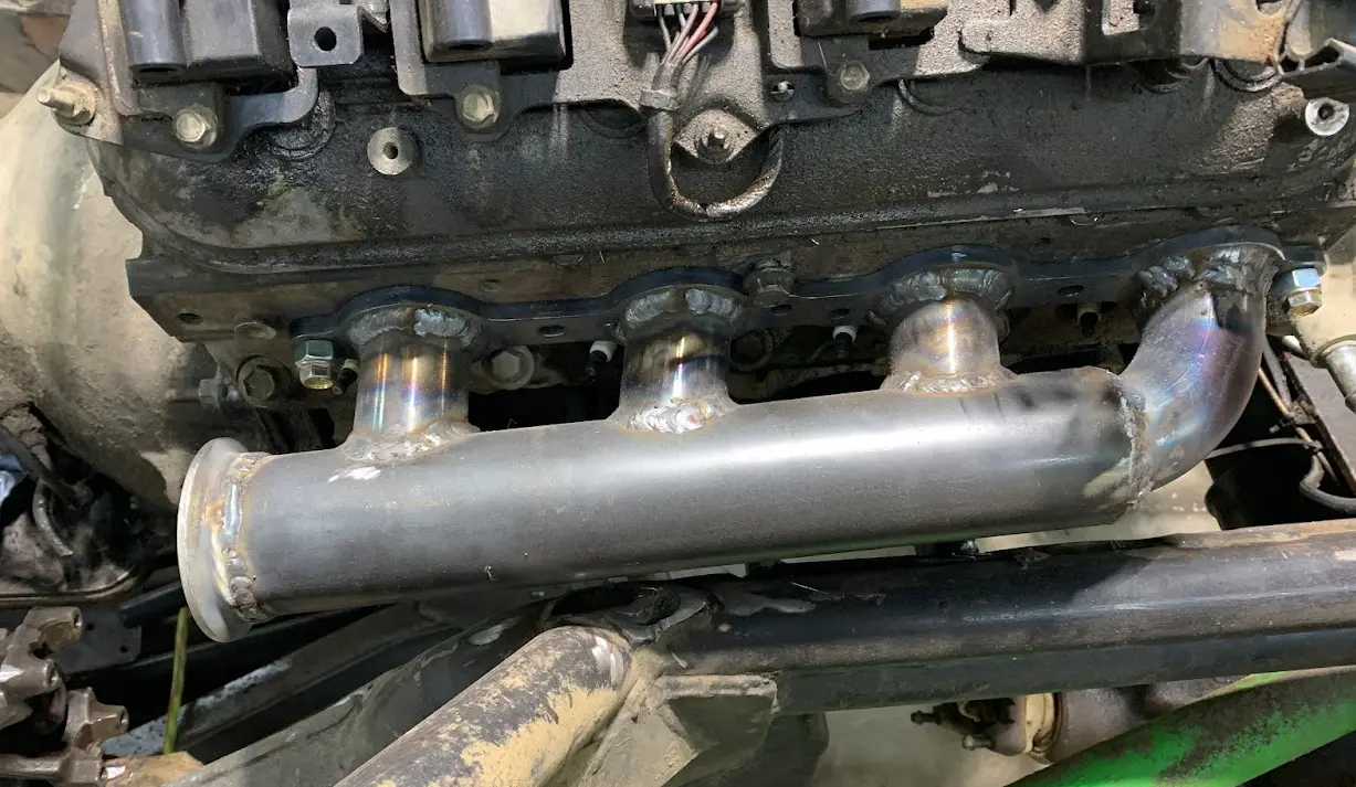

I haven't had any complaints, but I'm mostly idle or just off idle. If you are a throttle jockey, then they might be restrictive.
the log is 2.5" and i think it was 1.75 runners and its 3" just after it turns to go out the back

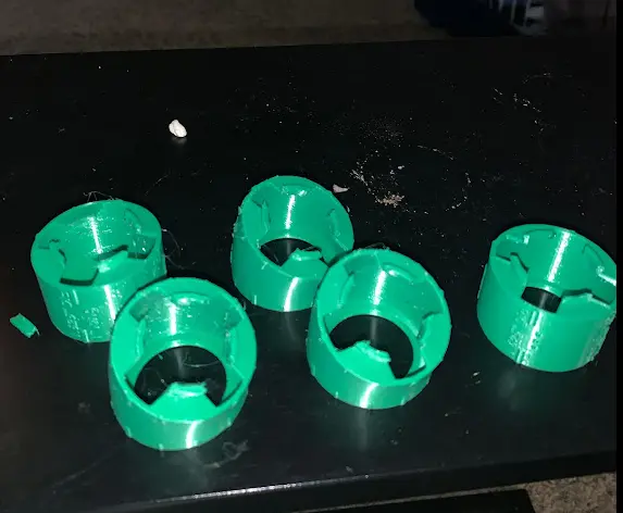

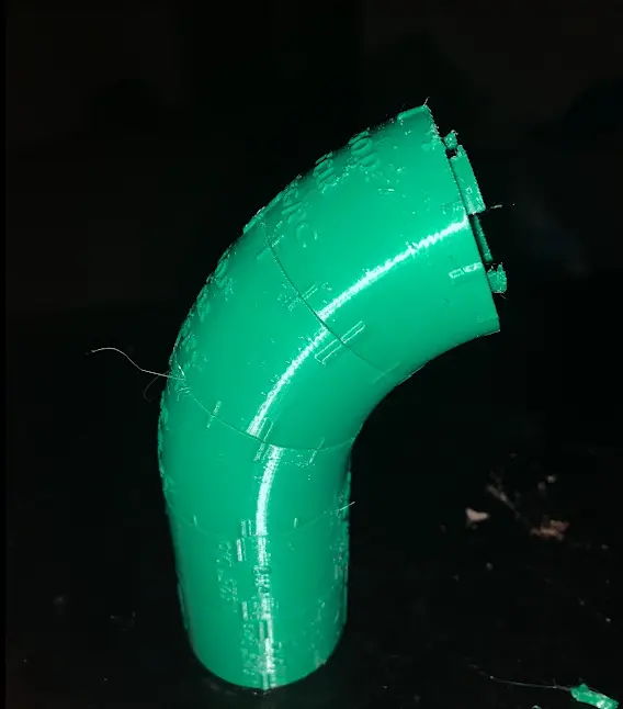

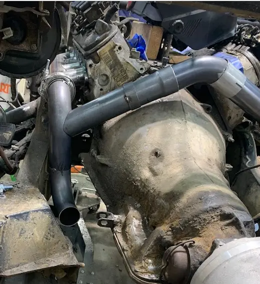

i started with some 3d printed exhaust header mock up parts
they snap together and you can rotate them to what ever works then take and recreate the tube. these things give you an idea. and because of these i choose to make a log.
