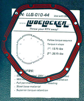

Now, thanks to our friends at LubeLocker, the entire job just got simpler and a lot cleaner.  These guys have used something very similar to head gasket technology and placed it on a gasket for your differentials. They have taken a thin sheet of steel and placed it between two layers of elastomer. This "sandwich" creates a gasket that when properly torqued down creates a seal between the diff cover and the mating surface on the pumpkin without the use of any sealers or RTV.

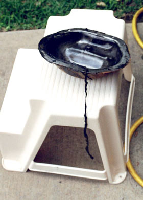

Yuck! RTV residue being peeled off of the cover
Cleaning the RTV usually just requires a little patience. However, it can be longest part of servicing your diff.  I generally use a razor blade to scrape the RTV off of the surface of the cover and a small scraper to clean up the mating surface on the housing.  I also run my hand carefully over both surfaces to look for small dings or scratches or places that I may need to file down or clean up before I put the cover back on.

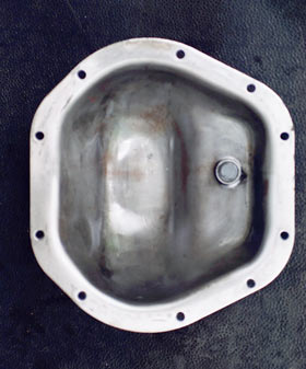

Inside of cleaned cover

Once I had everything cleaned up (including the bolts, because I don't want to force RTV back into all of those holes), it was time to lay another bead of RTV on the cover and - oh, wait, this is where LubeLocker's new differential gasket comes in.  Their new gasket does not require any RTV or any other material outside the gasket. Great!
LubeLocker, and instruction sheet
