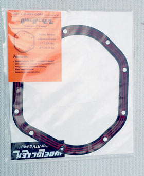

Simply remove the LubeLocker from it's package and install.  What could be simpler?
LubeLocker provides a perfect fit

New LubeLocker packaging
