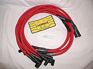

Although their product line has expanded to include high output alternators, ignition components, and specialty batteries, their mainstay continues to be the H.E.I. based performance Davis Unified Ignition (D.U.I.) distributor, and the popular high quality ignition wires known as “LiveWires”.

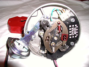

What are the advantages of a D.U.I. distributor?  Well, based on Performance Distributors marketing, there a quite a few, but let’s start with the obvious.  There’s only one wire to hook up.  You can throw away your old ignition module and coil. They’re history!
Your engine compartment is less cluttered.  The distributor housing and shaft are supported by upper and lower bushings for durability.
The main advantages are improved performance (increased torque & horsepower), improved throttle response and better fuel economy.  The internal 50,000 volt coil and Dyna-Module allow you to run wider spark plug gaps, up to .055”.  The Dyna-Module has more dwell built into it, allowing greater coil saturation time and increasing spark intensity.  This hotter spark results in a more consistent burn of the fuel mixture in the combustion chamber, meaning easier starting and smoother acceleration, as well.

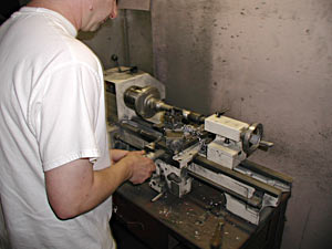

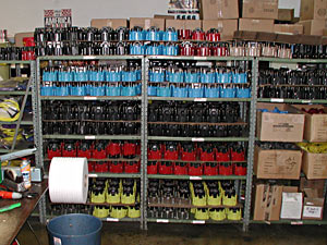

Here you can see a few of the distributor housings, caps, shafts, and drive gears built to Performance Distributor’s specifications to fit various engines.  Shop Foreman, Scott Sowards, is at work cleaning up a housing on a  lathe prior to assembly, not only to improve its appearance, but to insure proper clearances.

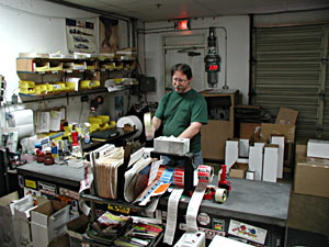

Since each distributor is built specifically for the customer’s engine, they are not pre-assembled.  When the order comes in, the crew at Performance Distributors goes to work assembling the distributor shaft into the housing, adding the drive gear and installing the Dyna-Module high performance ignition module.  The timing advance centrifugal weights and springs are then custom-fitted based upon the engine specs, weight of the vehicle, weight of vehicle towed, type of transmission, type of fuel, etc..  Each one of the factors has an effect on engine timing and a direct effect on vehicle performance and fuel economy.

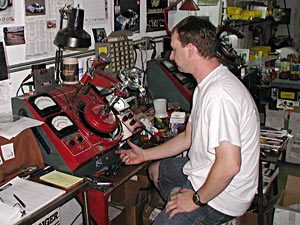

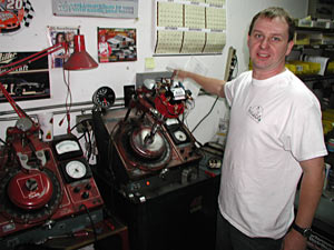

Once assembled to this point, each distributor is “chucked up” in a distributor machine to verify the timing advance is dead on.  With few exceptions, Scott custom tunes each distributor.  Once exact, both springs and weights are marked in red to allow for proper reassembly, should it ever be needed.  Also, an ID number and specs are marked on the bottom of the distributor housing for future reference in case you make modifications to your engine later on.  If so, simply pick up the phone and give them a call.   Based on your proposed or actual changes, Performance Distributors can tell you if you’ll need to change your advance curve accordingly, and exactly how to do it.  Or, you can send your distributor to them for modification. Easy!
Performancd Distributors

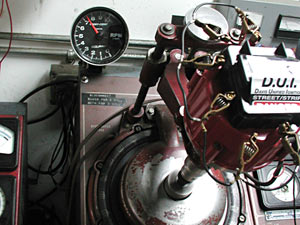

Once completely assembled, the distributor is placed in another distributor machine designed to verify that everything is working like it’s supposed to.  After initial testing, Scott ran this one up to over 7,000 RPM, well over the normal operating RPM this specific distributor was intended for, with no problems!
One little trick used to reduce the possibility of spark scatter inside the distributor cap is nylon rotor hold down screws instead of the factory metal screws.  Arcing across a rotor screw and spark plug terminal will not only cause poor performance, it can lead to costly engine damage!
