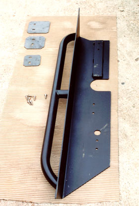

Our new ShrockBars arrived from Shrockworks well-packed and protected. Ours were ordered unpainted and we coated them with a nice thick primer and followed it up with two or three coats of gloss black. The ShrockBars can be ordered with a powder coat finish which we did not opt for, because we believe that paint is easier to fix and touch up after each trail ride.
In the box you should find the following (or similar, depending on what you order and your application):
  • 2 Rocker Guards (1 Passenger Side, 1 Drivers Side)
  • Interior Backing Plates – 2 Large, 2 Medium, 2 Small
  • 14 Stainless Steel 5/16”x1” cap screws
  • 12 Black 2 ½” x 5/16” flush head cap screws
  • 27 sets 5/16” nuts and lock washers
  • 13 5/16” washers
  • 15 5/16” fender washers
They include one set of extra fasteners in each kit just incase they miscount or you lose one during the install (nice touch and in my mind it shows that these guys have been there and want to make your installation go smoothly).
Start by sitting back and admiring how nice everything is put together. This is where we really noticed that Shrockworks bars are unique in many ways. First off, they provide a completely smooth surface underneath the vehicle. Shrockworks has taken the time to provide all the flush-mounting hardware and create recessed mounts for all the bolt heads under the vehicle. The welds are cleaned up and flow nicely, which is something some manufacturers can fudge and cover up during powdercoating. In addition, their attention to details like the use of welded-on metal blocks for support against the underside of the body (as opposed to some competitors that use plastic spacers) and the angle and spacing of the external tube and supports makes this a clean-looking functional part that should last through many years of abuses. Also note that they have left a hole where the stock TJ floor drain is at.
