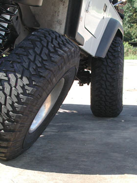

Of course, we did a little safety road test around the neighborhood before taking the Jeep out on the main road. After the initial test drive we found that the suspension felt really stiff, but we assumed it would settle once it got some miles on it.

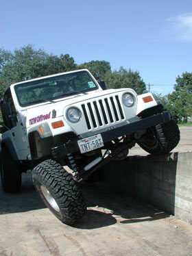

The first thing we did was to drive the driver's side up the dock.
X-Series
X-Series
We were quite surprised by the amount of travel we actually got out of this kit. We realize that ramping is not real world but the Jeep pulled itself up to max flex with no issues and nothing binding. It should be noted that the majority of movement is upward travel, as the suspension has very little droop. But again, if it settles down a bit this will remedy some of that.

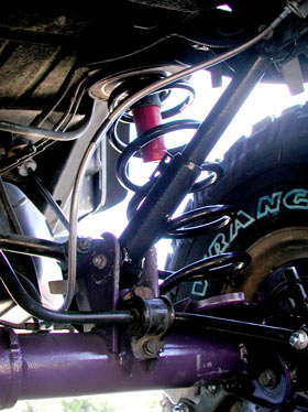

Here are the views of the upper control arms from the top. Even with maximum twist the arms are not deflecting the bushings, meaning that even with use they should last quite a while.

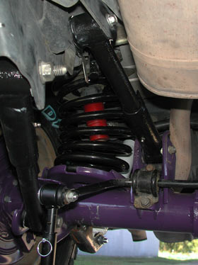

In the rear with the driver's side up on the ramp, there is plenty of brake line and the springs do not appear to be past their compression point. Again, nothing seems to be over-stressed, which should lead to longer component life.

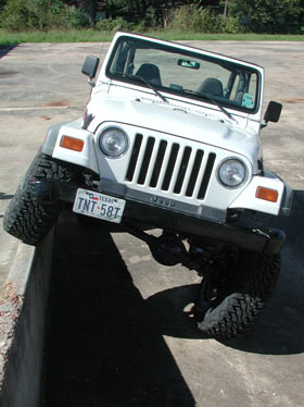

Then we ran the driver's side up the dock.
X-Series
X-Series

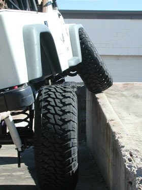

Again, it easily reached max compression travel. Even with what felt like a stiff suspension, it felt very stable on the ramp.
X-Series
X-Series

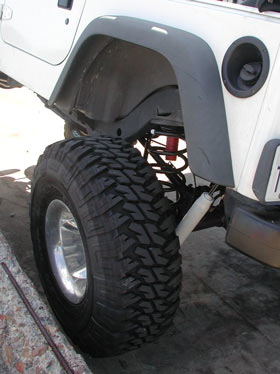

As you can see, the tires easily stuffed into the front fenders. The movement in the front is exactly where it needs to be. The biggest issue we had is that the tire will remove the factory bumper end cap if you don't remove it ahead of time.

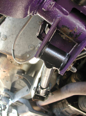

We just thought the photo on the left was a cool photo. The one on the right shows the force being applied to the lower control arm. The bushing is not distorting to the extent we expected. The articulating arms, while not really moving too much, are reducing the stress on the mounting points.
