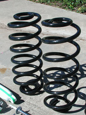

As we inspected the parts that came with the kit we found a few pleasant surprises. The kit is really complete, and included stainless steel and coated brake lines (which were very high quality), front and rear coil springs (the rear springs are side-specific which is supposed to offset the TJ listing problem), upper and lower adjustable, articulating control arms, front adjustable tracbar, front and rear swaybar disconnects, drop Pitman arm, four Nitro 9000 gas shocks with boots, steering stabilizer and all the necessary parts and brackets to install the kit.
On the left you can see the control arms. In the top left picture you can see the offset used on the lower control arms which helps to reduce the issues associated with a short arm lift. They rotate in the middle to adjust length and to keep the end bushings from binding at flex. On the right you can see the difference in the left and right rear springs. |
