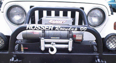

We've always been
happy with our Ramsey Pro Plus 9000 and when the opportunity came to try out
the Platinum, we just couldn't say no. Ramsey made a lot of promises about
faster line speeds (7 feet/minute with a 9,000 pound load) and lower power
draws (400Amps at 12Volts), so we wanted to find out if they were true.

So how did the winch work in the real world? We got
several opportunities to try it out at the Rosser Roundup during Memorial Day
weekend. The first use was on the Slick 50 trail toward the end. We were in a
nasty spot and we needed a good 70-80 feet of the 150 available in order to get
to a safe anchoring tree. The hill was very steep and this was going to be a
wonderful test. We wrapped a tree-saver around the tree and attached the winch
hook to a clevis hook. We also put our hood up and put a jacket on the line as
safety measures.
We weren't
expecting to notice as much of a difference from our previous, Pro Plus 9000 as
we did. The first part of the pull was almost a dead lift upward over some
stubborn rock ledges. The Platinum kept pulling hard and fast and we barely
cracked our hand throttle to keep the battery charging. We went the whole way
up without having to stop to recharge the battery and without having to high
rev. the motor. Before we knew it, we had crested the top.
The Jeep behind us
took almost twice as long to get up the hill, using his hydraulic winch.
Within another 50
yards, we had to winch again, and the Platinum was stellar on that step, as
well, producing the same results; fast, low amp draw, and steady pull.
