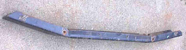

Kennesaw Mountain Accessories CJ Bumper
The stock bumper on this CJ-7 had suffered some trail abuse. As you can see, both ends had been bent back.
