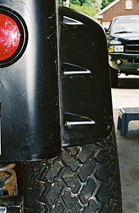

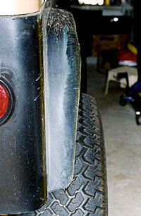

The flares covered everything I needed covered and did so on both sets of my wheel and tires. Since I use my Jeep for a daily-driver, I run 35x12.50x15's on 8.5" x 15" Rims with 3.5" of backspacing on the street and 36x12.50x15's on 8.5" x 15" Beadlocks with 3.5" of backspacing. As you can see in this side-by-side comparison between the stock flare and the Bushwacker flare, the Bushwacker flare comfortably covers up the tire tread.
To give you another view or idea of the difference between the stock front flare (on the left side of the picture) and the Bushwacker flare (on the right of the picture).
