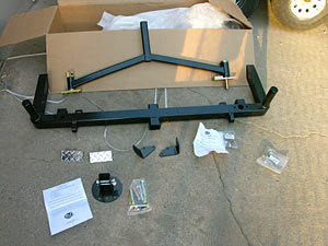

Big Daddy Rock Rear Plus Bumper and Tire RackThe bumper came in one box and the tire carrier in a second box. Somewhere between North Carolina and Colorado the tire carrier box got a large hole in it. I got lucky again. The folks at Big Daddy actually package all of the small bolts and brackets and things in a box all their own, so no parts were lost. I have had other similar products where they just throw the loose bags-o-bolts into the box without much thought. Had that been the case here, more than likely, the things needed would not have been there. It’s a small thing and I’m sure it’s an expense to the folks at Big Daddy, but it meant a great deal to me to not have to chase down parts for a new bumper that I was excited about getting on the Jeep right away.
As with any project, it’s always more fun with a friend. I got lucky last year when Rockcrawler.com staffer, Shawn Pagan moved to my area. He’s a real talent, a nice guy, and was fine with coming over for the install.
We unboxed the bumper and carrier and, to my delight, found that there really is not much to this installation. The folks at Big Daddy have really thought well of whom they want to make this bumper for. In business talk; they know their target market well. This whole system is designed for ease of installation and long-lasting durability.

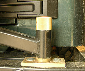

The first thing Shawn said was “nice powder coating,” and it is. The product is made to last. I noticed that there were some parts that looked to unique to Big Daddy items, meaning not off-the-shelf. The hinge, the latch, the catch, even the plate that the tire mounts to was unique. In the pictures you will notice the brass-looking items (actually, all those parts are zinc-plated) are all unique to Big Daddy. They actually make all the parts for these bumpers right there in-house. They don’t go buy just any old spindle and hub and then piece it together into a bumper. Each part is made with a purpose in mind. The cool part, though, is that if you ever need bearings, these are standard model numbers and you can go to a parts house and buy those.
Hinge
Latch
There’s so much to cover on this bumper! The carrier bearings are in a sealed housing, so there is no need for continual greasing. The unit comes already packed with grease and is ready to go. Most other carriers that I have seen have zerks and need to be cleaned up from time to time. The last carrier I bought needed to be greased at assembly. Sure, most four-wheelers have grease guns, but for the folks out there that do not, it’s just another thing that they need to take care of. The fact that it is all sealed means that you’ll never have a greasy mess there to collect dirt. Better yet, the elements of weather that harm bearings won’t get in.

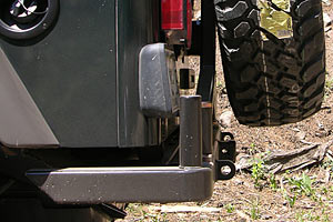

The bumper itself is very nicely thought out. For the Wrangler Unlimited with their additional length behind the rear tires, I was somewhat worried about the potential to land on boulders with that rear quarter panel. The Rock Rear Plus Bumper actually wraps around under the tub to protect that area. The bumper has a receiver in the middle and two D-ring tabs welded into the bumper right where the bumper mounts to the frame, which would be the strongest location on the bumper. These things are beefy - I mean they are fully-boxed steel bumpers.
Big Daddy Rock Rear Plus Bumper and Tire RackThe Rock Rear Plus Bumper also comes with posts for corner protection. With my ‘99 I did manage to get into a couple of places that just caught my corner guards and since I have yet to get corner guards for this Unlimited, and the fact that I now have more rig following behind me, I like the idea of those posts. Maybe on this Jeep I’ll even be able to keep the license plate bracket in better shape.

A nice thing about the Big Daddy instructions is that right up front you get a parts list to compare against the parts that actually arrived. I always recommend going over this list before you actually start the work in case something is missing.
One of the coolest things that I liked about Big Daddy is that the tire carrier (which does have many small parts) comes almost fully assembled. You will notice in the picture of when we first un-boxed the items that the pivot is not something that you will need to put together. Again, I’m sure that it takes extra time at the factory for them to do the assembly, but I appreciate not having to learn how to assemble the device.

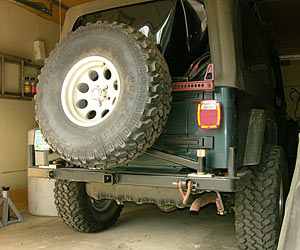

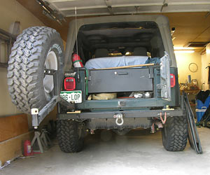

Big Daddy Rock Rear Plus Bumper and Tire RackThe next step is to drop the carrier into its’ respective holes on the bumper. This is the point where Shawn and I noticed something was different. The Big Daddy carrier is hinged on the left instead of the right as are most other bumpers that we have seen. The reason for this is so that when the carrier is open, the Jeep tailgate does not bang against the carrier. For some, the idea of saving the paint and the tailgate from damage is a nice feature.
The thing that I like about the left hinge is that, traditionally, all TJ’s seem to sag on the right rear spring. With the additional weight of the open carrier it really leans. Not so with the Big Daddy set up, since the weight shifts to the driver’s side.
The tolerance of the spindle shaft and the hole in the bumper is nice and snug, we needed just the right amount of pressure to get the pivot base in place. We installed the carriage bolt and moved on to the next step.
We rotated the carrier to its closed position and put the carriage bolts in their respective holes on the closure end and checked to make sure that the screw pin operated correctly.
All fit perfectly and we tightened everything down.

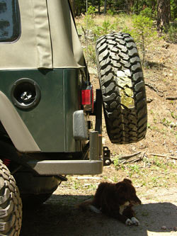

  • Big Daddy Rock Rear Plus Bumper and Tire RackWe noticed that the tire itself sits lower to the ground now. In other words, the spare tire’s weight is now lower, affording a lower center of gravity and better visibility out the back of the rig. The tradeoff, once again, would be the chance of hitting the tire on some obstacles. You will notice from the pictures that the tire does sit at a slight angle from plumb on the carrier. This has been done to lessen the chance of hitting on obstacles.

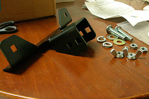

Installing the Hi-Lift bracket involves removing the bolts from the adjustable tire holder and then placing the jack mount holder over the tire holder, reinserting the bolts and tightening them up.
You get two long carriage bots that go into the jack holder and you tighten those to the holder and then install the jack by placing the jack over the bolts and securing with some large wing nuts.
Again, this was all well thought out and simple. The jack fit well and snugged up nicely to the tire so there should not be any rattle. I did make sure that my cotter pin on the Hi-Lift base was secure and I used a strap to make sure that the handle of the jack was secure.

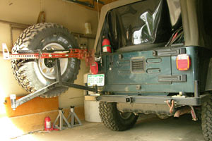

While installing the jack holder I did notice that when tightening the jam nut that holds the carriage bolt in place, it is a good idea to use a Crescent wrench to keep from bending the holder.
