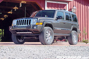

This zebra-inspired, Superlift / AEV-equipped Commander can be viewed "in the flesh" in Jeep's booth at the SEMA show November 1 through 4. |
