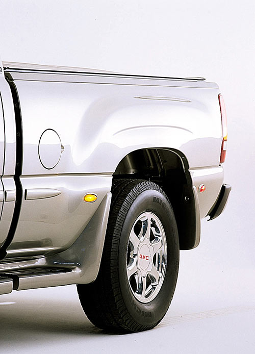

To allow more
turning clearance for the rear tires, the Quadrasteer-equipped
Sierra Denali has flared composite rear fenders that give the
vehicle a brawny, capable look. Their reinforced reaction injection
molded construction also resists dents and corrosion.
