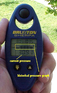

Enter a new electronic gizmo called the Brunton Sherpa. Don't think that because this device is named "Sherpa" that this device is limited to high altitude hikers (Sherpas are the Nepalese natives who serve as the backbone of Himalayan expeditions). The Brunton Sherpa is well suited for any type of amateur weather forecasting.
One of the best things about the Brunton Sherpa is that it displays an easy to read sixteen hour history of the barometric pressure in a column graph so it is easy to see the current pressure and determine if the pressure is rising or falling.
The image tells us quite a bit about what kind of weather we can expect. First, let's look at the historical graph. The historical graph is a column graph and we can see that there are five entries along the X axis. The five entries along the X axis represent measurements taken over the course of 16 hours. The graph is read left (oldest) to right (newest) measurement. The graphs on the X axis represent the hours 16, 8, 4, 2, and 0.
So, we can see that between 16 and eight hours ago we saw a rise in pressure. After the rise in pressure seen over eight hours ago the pressure has held steady. The longer the pressure has held steady, the longer we can expect the existing weather to remain the same. On the flip side, if we see a rapid rise or fall of pressure we can say that the current weather state will probably not be around that long.

The current conditions (when the picture was taken) was sunny without a cloud in the sky. The pressure is holding steady over the last eight hours and it rose between 16 and 8 hours ago, so I would expect the same sunny skies overhead for the remainder of the day.
