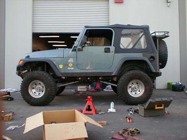

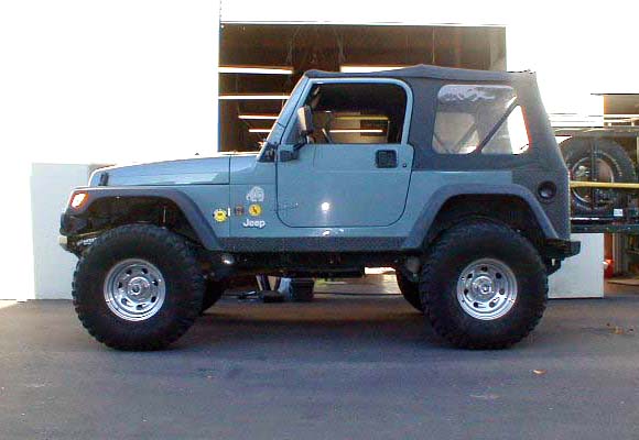

Take a look at the amazing clearance you now have! We immediately measured the height of the Jeep:
  Before After Gain
Bottom of front bumper 24.5" 28" 3.5"
Bottom of rear bumper 24" 28" 4"
Bottom of crossmember 16.5" 20.5" 4"
BEFORE: Click for larger picture.
AFTER: Click for larger picture.(Remember, its 1 inch lower due to body lift removal)
The height difference is incredible. Allowing for some break in, the height gain should be about 2” over the 4.5” kit. Keep in mind with these after pictures that I removed the 1” body lift in between installing the rear end and the front end. The above measurements include 1” for the body lift.
