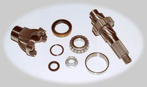

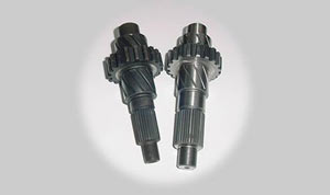

JB Conversions HD Front Output Shaft: Another potential weak area is the front output shaft. Although normally not subjected to the abuse of the rear shaft, mainly due to weight transfer, upgrading the front shaft is definitely a good idea if you wheel hard or are competing. JB Conversions has designed a kit that includes a 32 spline shaft, new yoke, bearing, seal and small parts. Check out the comparison between a stock shaft and the JB Conversions shaft in the following photo.
Because the shaft is much larger, the bearing must also be larger. This requires machining of the aluminum front bearing retainer housing accordingly to fit the larger, stronger bearing race. Instructions include detailed information your local machinist can use to do the job. The cost should run well under $100 and most-likely half of that amount, depending on hourly labor charges in your area. If you can't find a machinist who will work with you, JB Conversions has a local shop you can send your housing to for machining at a fair price.
