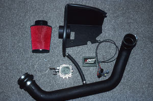

The
new Trail Jammer system comes complete with all necessary
parts for the simple installation.

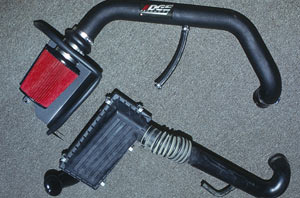

The
Trail Jammer’s (top) high performance filter
flows 97% better than stock, (195 cfm compared to the
OEM 99 cfm).

The Trail Jammer kit includes three main components: a throttle
body, an electronic module and a cold-air intake system. Edge’s
high-flow throttle body with a 62mm bore accommodates increased
airflow and improves overall driveability. The Edge Trail Jammer
Electronic Module optimizes fueling between the Jeep’s
PCM and the 4.0L engine on-the-fly. This black box uses a factory-style
harness to plug into engine sensors under the hood. Air enters
through the Trail Jammer’s cold-air intake (built by AFE),
which flows 97% better than stock, (195 cfm compared to the OEM
99 cfm). The system’s oil-impregnated, cotton-mesh filter
traps dirt and debris, and is washable & reusable.

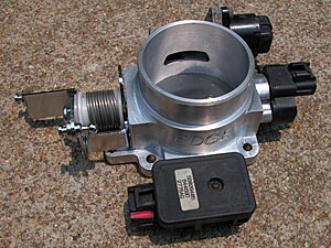

Edge’s high-flow throttle body
(right) with a 62mm bore accommodates increased airflow
and improves
overall
derivability compared to the stock (left) 60mm.

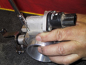

The MAP (Manifold Absolute Pressure) sensor was moved
over to the new throttle body.
The
idle controller was moved over using a small Torx bit driver. |
Completed Edge throttle body assembly. |
(Editor’s
Note: swapping the idle control box requires a Torx screwdriver.
In addition, early model TJ’s have
a secure Torx bolt, which will require a special bit. Craftsman
Tools offers a secure bit set which includes a range of bits
including the one needed for this task)
