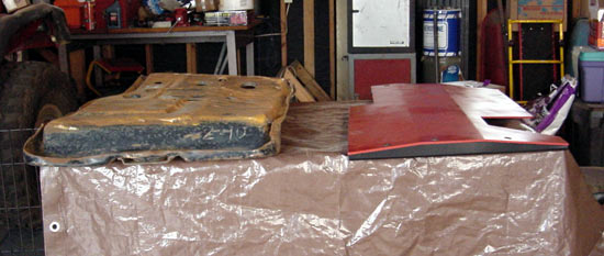

Stock TJ crossmember next to a complete 33 Engineering crossmember
With some experience under our belts from installing and using these aftermarket skid plates, we were intrigued when we looked at the new plate designed by 33 Engineering. Their new design had a number of features that we found to be stand-outs. The coolest, by far, is the fact that the 33 Engineering Plate is designed as a two-piece system. Unlike the stock transmission crossmember or any of the aftermarket ones we had seen, you don't have to have jackstands or jacks to remove the skid plate in order to do maintenance or inspections. In addition, the plate is designed for maximum driveline angle clearance.

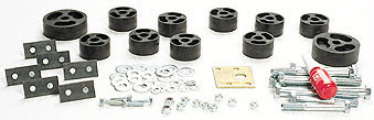

Like most of the other high-clearance skid plates on the market, 33 Engineering's requires you to install a 1" body lift and a 1" motor mount lift in order to keep proper driveline angles and to keep proper clearance between your transfer case and the floor pan of your Jeep. In most cases, they also recommend having a Slip Yoke Eliminator Kit (SYE) and using a high-angle or C/V driveshaft.
After receiving the skid plate, we picked up the phone and called Michael at Collin's Bros. Jeep and he hooked us up with Mountain Off-Road Enterprises (probably better know as M.O.R.E.) for their new BombProof Motor Mounts with "Torsion" Rubber bushings and 1" Motor Mount Lift (Part #JM603L) and also drop-shipped us a Performance Accessories 1" Body Lift. The test mule (in this case, my father-in-law's 1997 4 cylinder TJ) had a new (to him) 231 Transfer case already prepared with an Advance Adapters Heavy Duty Slip Yoke kit and a new C/V driveshaft so we were now set to get started.

Performance Accessories Body Lift
